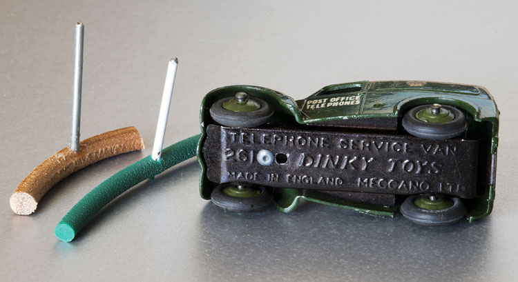

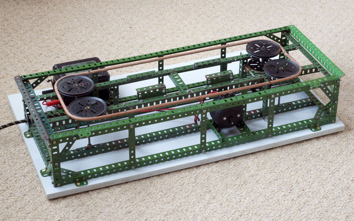

This was the basic Meccano framework complete and awaiting the fitting of the road bed. The above shows it fitted with a drive belt of leather as recommended in the Meccano Magazine description - these are commonly used on sewing machines. Once I had the road bed and the drive pins fitted in the drive belt, then came the fun. I just could not get it to function correctly, it constantly kept slipping of at the corners. The leather belts available were either 4mm or 6mm in diameter. The 6mm was too big and kept slipping off and the 4mm was just too small. After further digging around on e-bay I found a belt made from a modern green synthetic material which was 5mm in diameter and it is perfect. I did have to drill small holes in the baseplates but these were unboxed items that I had purchased at a fairly reasonable cost. This is supposed to replicate a Dinky dealer shop window display so I did not want playworn vehicles going round. Dave

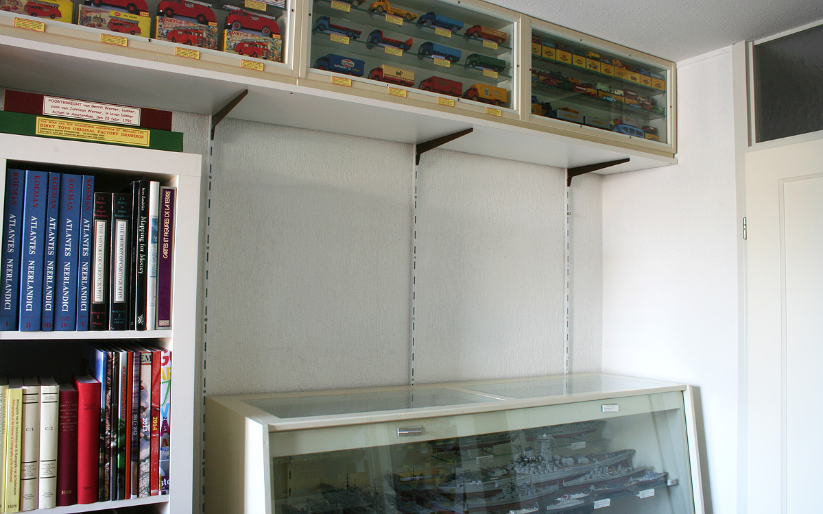

Just finished a complete refit of my 'ceiling displays'. Both the interior finish and the lockings have been improved and the construction of the whole unit has been fixed more sturdily. They are virtually 100% dust free now. A nice opportunity for some reshuffelling, placing i.a. the Fire Engine sub-collection in the centre. Kind regards, Jan PS: I did not compensate for the artificial light, so the colours of the pictures below are horrible!

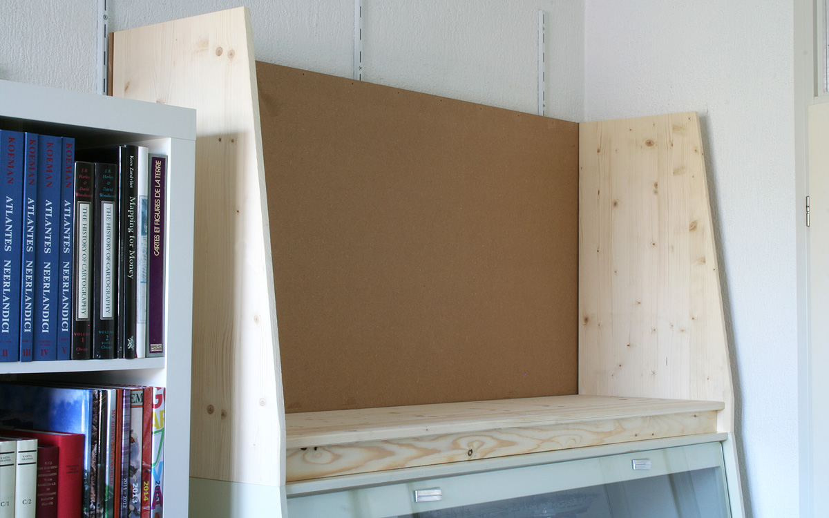

The study/hobbyroom changed into a busy (and tight) workroom this weekend, making quite some progress with the new extension of my display facilities. Two shelves with periodicals and atlases were removed to accommodate a new display unit on top of my ships models unit. It will have the same frontal slope continuing upwards to reach the narrower shelve with 'ceiling displays' which it will support in the end (these, and their contents, have been temporarily removed now). I made the final design scheme at the end of last week, bought some timber and started sawing, fitting and fixing the main rough construction this weekend. Finishing the outside and inside to be continued ... Kind regards, Jan
