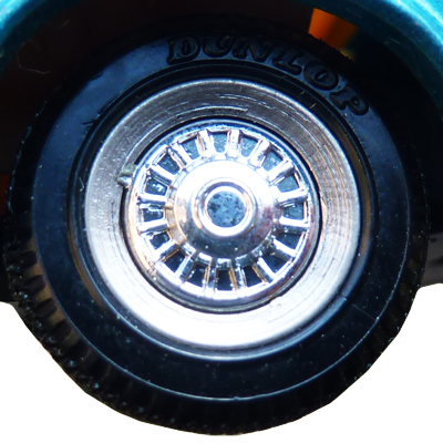

John, Many thanks, this fills the Encyclopaedia which is still missing a lot but is slowly growing. Bruce, Here is a similar wheel with spun aluminium hub and polished or chrome plated cap which was fitted to the ref. 1409 Chrysler 180. The hub is probably the same as for the Peugeot 504 but the cap is different.
