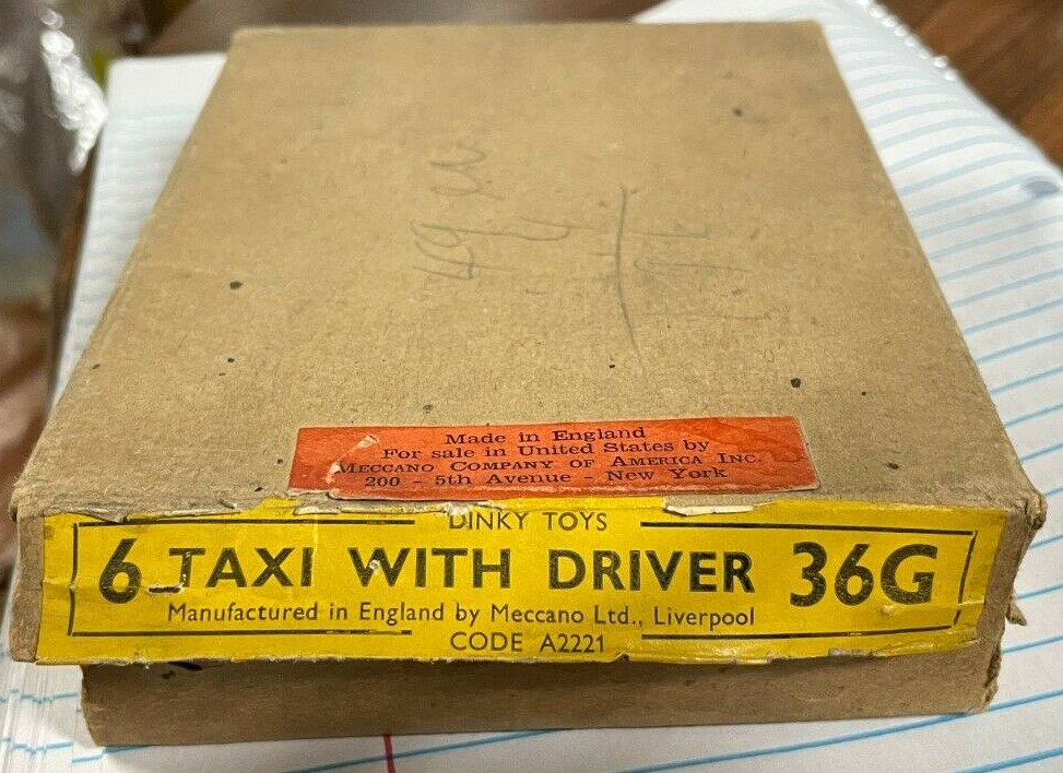

5 years 2 months ago #23332 by DavidT
Replied by DavidT on topic Trade Boxes
My most recent purchase may give us a clue to more accuratly date this type of box as it has a label on the lid referring to the importer to America. As of yet not researched this label, but expect some of you will recognise immediatly. David
5 years 2 months ago #23333 by bakalkeeling
Replied by bakalkeeling on topic Trade Boxes
The yellow textured boxes without numbers succeeded the boxes with numbers - as far as I know - but I could be persuaded probably. The cartouche logo is a slug - in mediaspeak, any text in a bar is a slug.I don't know if there are any prewar boxes without A**** numbers. At least I don't have any reference of any. 200 - 5th Ave NY was the address of the Meccano importer to the USA from about 1913, initially trading as The Meccano Company of America Inc. Labels from 1938 start to replace MCoA Inc with H Hudson Dobson, the name of the trader himself. The history is shadowy but his activities eventually wound up as the 60s began.
5 years 2 months ago #23338 by DavidT
Does that therefore date my latest purchase tpo pre 1938? David
5 years 2 months ago #23341 by bakalkeeling
The first mention of H Hudson Dobson is said to be on the cover of the 1938 Meccano Catalogue USA edition. You'll probably recall that these catalogues have a space to overprint the address of the local dealer.Your taxi box is the kind we associate with war austerity - although we only assume that austerity was why the boxes were simplified. And we don't really know how long it took Mr Dobson to use up all his old labels - if there was a war on, he might not have wanted to waste any. I'd speculate the taxi box was towards the last of the prewar production.
5 years 2 months ago #23343 by johnnyangel
Replied by johnnyangel on topic Trade Boxes
Thanks for your good comments, Al. I was going to chime in but I didn't recall the date of when H. Hudson Dobson was first mentioned. All these years later, we still don't know why the Meccano Company of America -- which H.H. Dobson was already running -- was renamed for the man himself. Did it represent Dobson taking more of a financial stake in the distributorship, or was there some other legal reason? In any case, the address remained the same, and I think you are quite right that the Meccano Company of America labels were simply used until they ran out. I agree with you that they stayed on boxes through the last of the prewar production. Indeed, as anyone seen an 'H. Hudson Dobson' sticker on a prewar box? I think items may not have been labeled as such until after the war ...
5 years 2 months ago #23345 by bakalkeeling
Dobson was a British emigree ... a Liverpudlian who arrived in New York as a young man before WW1 and told the US draft board that Meccano was his employer. Was he some kind of representative on mission for Meccano even on that first crossing? I had a look through my reference images and did not find any prewar red labels with Dobson... they are all Meccano Co until after the war.
