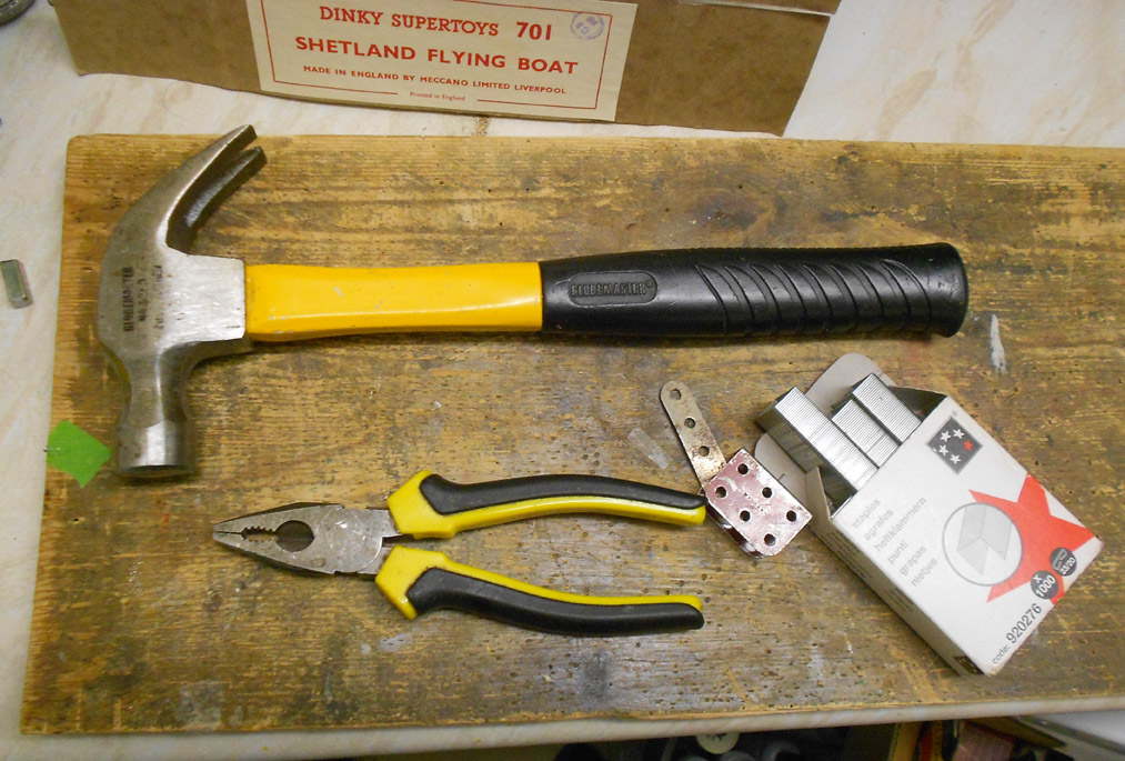

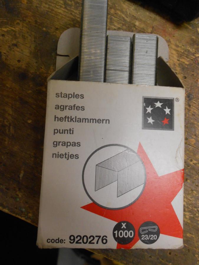

I'll see if I can make a fake staple making video tonight. Using only tools probably everyone has lying around - a bit of wood, a hammer, pair of pliers and (optionally) some bits of meccano. For staples, I use 23/20 - my brand is 5staroffice. Jacques is very likely correct that a box stitcher would have been used on the original trades.

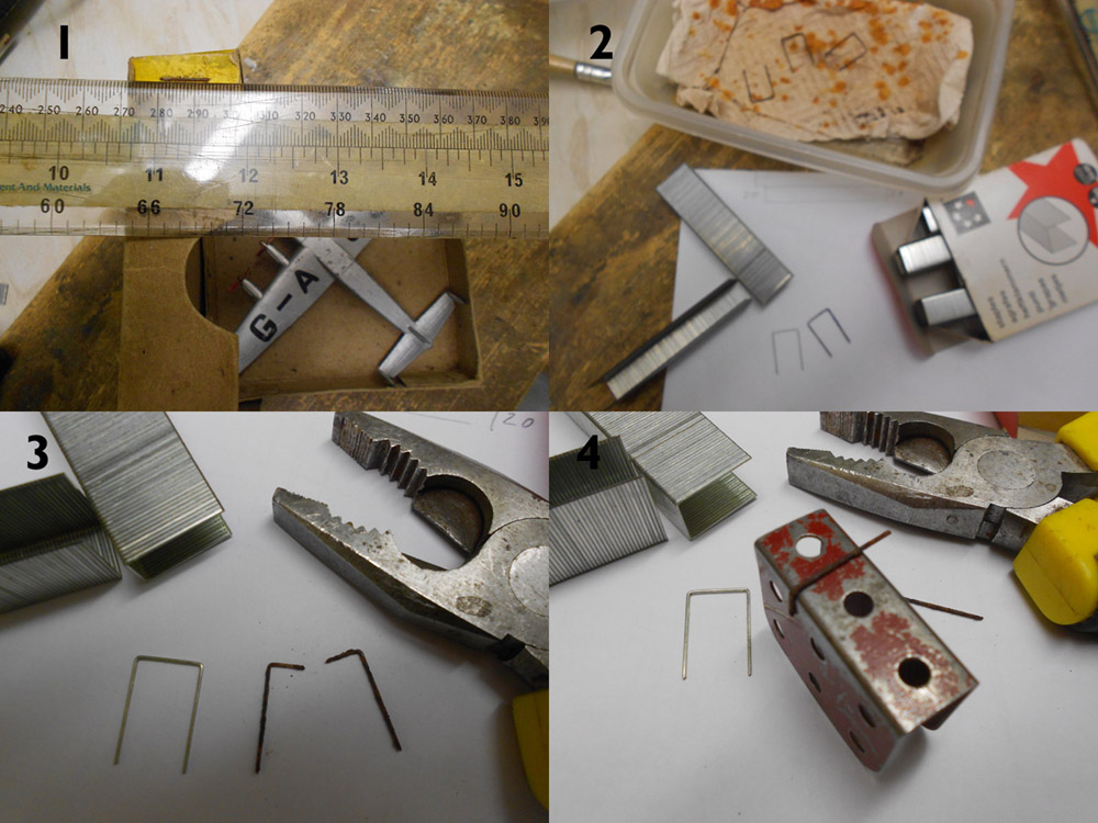

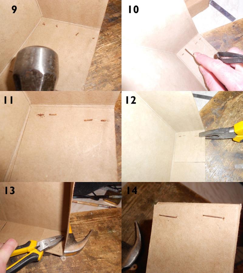

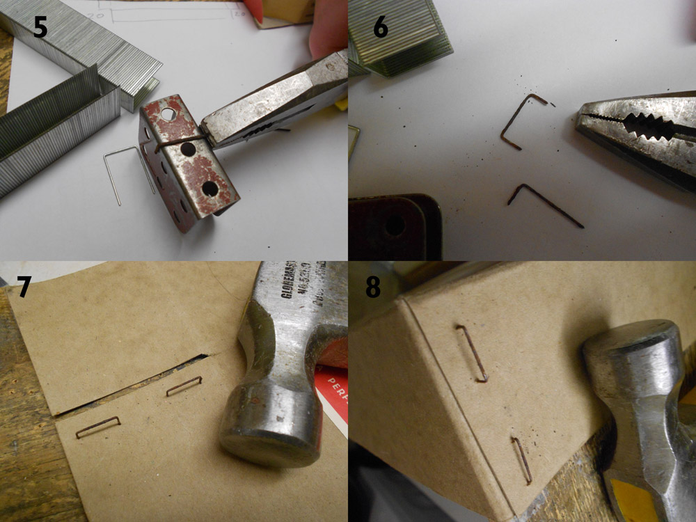

Trade box fake staples - how to make and install them. An original Dinky trade box staple (1) is about 14mm on the crown. Now I could not find any manufactured to size staples but I can buy 20/23 large staples (2) in boxes of 1000 from most stationers, split them apart and scrape off any glue. They are, of course, not rusty staples but a few days exposure on a tissue soaked in salty water soon acquired the required appearance. Then I cut the staples mid-crown (3) with the pliers - just judging by eye. Now it just happens that a Meccano channel bearing is just the right width (4).. but you could make a wad of glued card as your measuring guide. Gripping the leg of the staple with the plier jaws (5), I bend 90 degrees and now I have a new staple with a 14mm crown (6). I locate and tap in my new rusty staples through the first layer of card flap (7). This bit of wood is a good size - about 12' x 24' - which I can straddle across my lap to get on top of the work. Tucking the lower flap and squaring up the corner with the edge of the board, I tap the staples through (
. Working the staples all the way through now, their legs are open and somewhat crooked (9) but I can generally fold them down with a strip of meccano - or a butterknife or whatever else you have to hand (10). They will not fold exactly flat (11) so they will need a squeeze from the pliers (12) to close them completely. Of course the pliers will not reach to crimp a deeply set staple but I use the hammer as a last and tap the staple with the nose of the pliers to close them up (13). And there we have the finised effect (14).
. Working the staples all the way through now, their legs are open and somewhat crooked (9) but I can generally fold them down with a strip of meccano - or a butterknife or whatever else you have to hand (10). They will not fold exactly flat (11) so they will need a squeeze from the pliers (12) to close them completely. Of course the pliers will not reach to crimp a deeply set staple but I use the hammer as a last and tap the staple with the nose of the pliers to close them up (13). And there we have the finised effect (14).Please Log in or Create an account to join the conversation.
