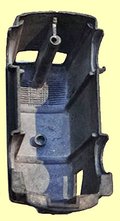

This is an other excellent description by Jan.May I add a couple of comments ? There are three casting variations which Jan could not see : smooth ceiling the rear third of the ceiling is chequered all the ceiling is chequeredThe original Chenard van sported a two strokes two cylinders flat engine and the front grille was flat but when the longer four cylinder engine of the Peugeot 202 was fitted the grille was moved forward. The 202 engine was changed for a 203 hence the reference D3 and later by the 403 when the reference was changed to D4. The van was assembled by Chausson as many other vehicles were : Peugeot J 7 and J9, Citron C35, Renault 4 van, Estafette, Opel GT etc... The Mazda van and Simca Aronde (24U) were the first French Dinky packed in a yellow boxes.

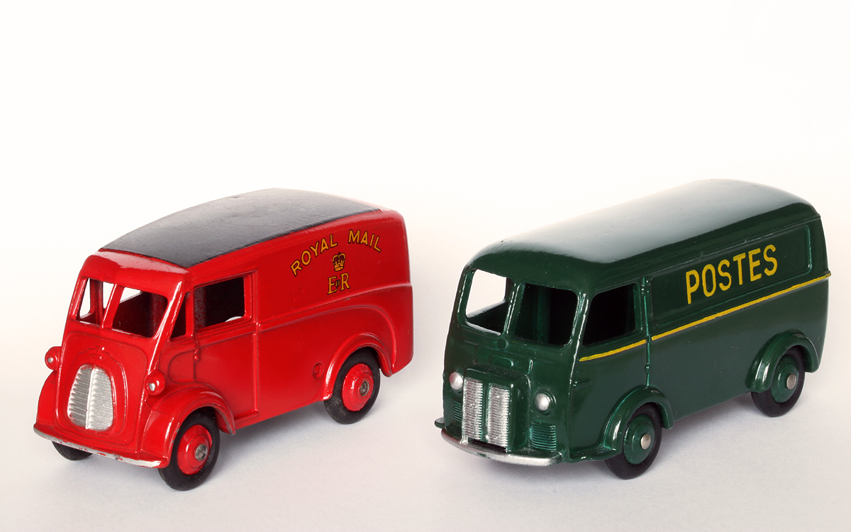

Jan--Another very nice writeup on a splendid 1950's Van by the French Meccano factory. Another comment spurred on by this model, is the presence of an open rear window. The English Meccano factory abandoned showing these shortly after the war, and newer commercial vehicles never had them. But the French included them in the long wheelbase versions of the 25 series Ford Trucks, plus this van, as well as the Citroen 2cv Vans, and the Citroen H van. I have always heard the English stopped due to the problem of excessive flash material needing to be removed by hand, so if that is the case, how did the French deal with it. Also, why was it an issue only with those rear windows? Thanks again for showing this! Best regards, Terry

Great additions, you guys, thank you! This is the way we should always discuss Dinky Toys and expand our knowledge and share our various views about them. I presume, Jacques, the full extent of the inside ceiling finish can only be inspected by dismantling the model? And, Terry, well observed, about those rear windows. That did not cross my mind yet. It must have been a cost issue of the British to prefer filling in the rear windows (from the start or lateron). As they were 'only secondary' the maintenance of the die (in order to avoid excessive flash) could be concentrated exclusively on the more important windows this way, in my opinion. The French probably just happened to make a different choice. Kind regards, Jan

Yes Jan, one can only see the 1/3 cross hatching when the van is dismantled. About the open/closed rear windows, the flash could not be removed automaticaly because those windows are two small. The deburing is done by placing the raw castings in a rotating barrel and mixing those castings with some abrasive synthetic stones. If the stones are much larger than the windows to be debured, this does not work properly. Bobigny and LIverpool had probably a different way of doing the deburing. Deburing was certainly not finished by hands, the models with excessive flash were certainly molten again. One can not do any work by hand when one makes one million Dinky a month. I know only two cases of filing castings : some of the Panhard PL 17 on which the indicators were filled off and one can see the scratches and the laders of the 32e - Berliet fire engine. Why did Bobigny succed to keep those small windows is probably because the dies were subcontracted and of better quality than those made in house at Binns Road. The problem was raised as early as 1934 when the small side and rear windows of the type one 25d tanker were closed and it was still not solved when the Binns Road factory closed in 1979 as the Convoy trucks had filled in rear windows.
