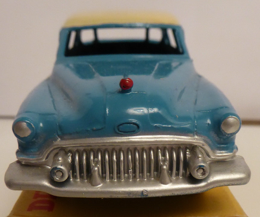

Dear Jan, I was not aware that the number of ribs in the front grill was different for the 1951 and 52 models.1) The 1951 issue has 25 ribs, the 1952 one has only 19 of these ribs just like the Dinky Model. I do not think that the tool makers could have made the Dinky with 25 ribs. 2) The over riders on each side of the front number plate of the 51 model are smaller than in 52. The 24v sports the small1951 ones. 3) The long chrome plated flashes on each side of the Dinky are as on the 1951 Buick. 4) The rear wings of the Dinky are of the1952 type. 5) The emblem on the Dinky's boot lid is of the 1952 type. All this makes the Dinky mainly a 1952 model. Have you spoted any more differences between both manufacture years ? Kind regards. Jacques

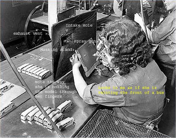

I found this photo with text about mask spraying on Planet Diecast.I have respect for the ladies who had to do this precise job day in and day out without the necessary respiratory protection. Each Dinky model required its own specific masks for the detailing and model 24v required I think a minimum of 5 different masks.I am not a specialist, but it seems that the mask plate is secured between clips so that it can be exchanged for a different mask each time. This job was done in several places side by side. For example, did the model have to dry after each mask spraying before the next mask spraying could be performed? That takes a lot of time per model. I hope Jacques can say something about the technique and process of mask spraying.As mentioned, the 24V model had to undergo at least 5 mask operations. 1. The front grille, bumper and headlights. 2. The rear bumper and trunk handle. 3. The left side decorative strips with 4 portholes. 4. The right side decorative strips with 4 portholes and 5. Different color on the roof. Also red tail lights and a red dot on the hood ornament had to be applied by hand.Model 24v was therefore laborious and required the necessary accuracy and skill to apply the paint completely opaque to the various details. The result has become one of the most beautiful Dinky Toys cars. We know that there are 24v models that left the factory without the side detailing for whatever reason. Unfortunately, we have to regard this as a factory error.Below a photo of my 24v Buick Roadmaster with silver sprayed side details as we would like to see them on each side of any 24v model. Also a beauty to see is the red painted hood ornament of the 24v.Jan Oldenhuis, 21 June 2021

Jan, The Encyclopaedia contains several photos about the mask spraying for the Dinky. On the home page's right hand menu there is a link to 'MECCANO FACTORIES'. Chose 'Meccano s.a. Avenue Henri Barbusse' and 'Meccano Ltd. Binns road'. Both these links contain photos of the static and hand held sparying masks.The girls did not need any protection against the paint as all the spraying stations were fitted with a ventilation system. The photos show the big pipes leading to the roof.For the Buick there were probably only two masks : one fot the second colour of the roof and one for all the silver details

Even with the extractor system in operation, there would probably still be some overspray in the atmosphere, and in earlier times the paint would have contained lead. This arrangement would certainly not be tolerated today.

Jan--I have long wondered and pondered about just how the masking was actually done, and also exactly what were the masks made of. One most Dinky models, the masking is done somewhat perfectly, with even coverage, and very tight, crisps lines, where the masking ends. Also, very importantly, there is normally no sign of overspray, which would happen if the mask did not fit very tightly. So I wonder just what these masks were made of....was it some type of synthetic material, that had a tiny amount of 'give' in it, so it could perfectly conform to the shape of the model to which it was applied? For some reason, I cannot fathom it being a hard material. On a very few of my Dinky's, there is light overspray, indicating to me that the mask was somehow not securely fastened or in place.Another amazing item, particularly with our Buick Roadmaster, is just how fine some of the masked areas are.....quite tiny. Maybe the best example I have noticed, that is just superb, is the rear boot or trunk handle on the Buick. I have posted a photo below of my blue, dark blue, very early one, and just look how thin that horizontal silver strip is......just incredible, and impossible to do by brush I would think. Wouldn't any of us give a small fortune to be amazingly transported back in time, to just a day at the factory, closely observing all of these long ago techniques that were not well documented , or samples of a mask saved!

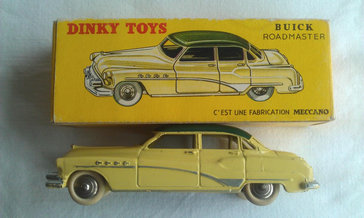

I have shown these boxes before, but thought it might be good to post them again, with all the recent interest in the Buick Roadmaster. The very early versions of the box are different: The illustration of the model has a 'shadow' on only the early version, plus the early ones contain the word 'Miniatures' on both the front of the box, as well as the ends.
