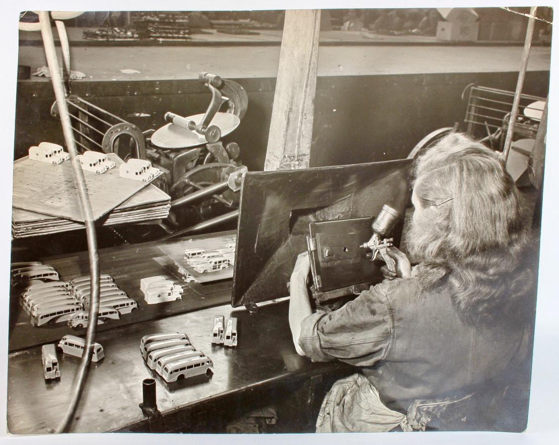

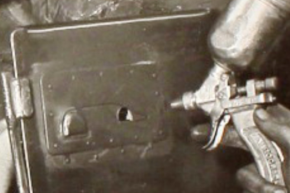

Looking very, very carefully at photo 1a, the outline of the side flash for the right-hand side of the coach can just be made out, and the 'hole' is actually the rear wheel opening. The coach body is already located in the mask, and may already have been sprayed, hence the uniform colouring. I would suggest that the bulge is merely there to locate the front mudguard within the mask, helping to align the casting. Strangely, there does not appear to be an aperure for the trim along the bottom edge of the body, unless there is one that is not obvious in the photograph.

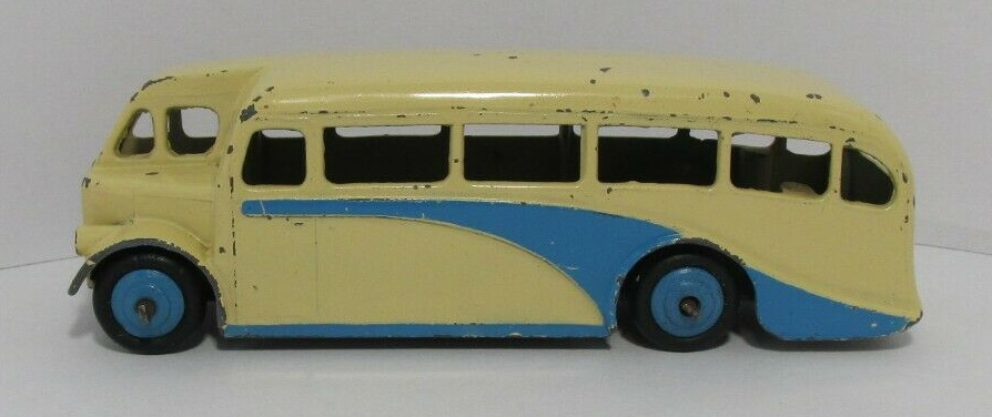

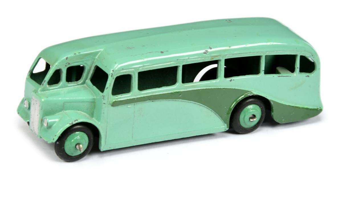

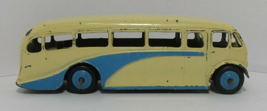

Kevin. Thank you very much for your response. I find your description very plausible. I think you mean the left side of the bus is placed in the mask with the opening of the left rear wheel in front of the hole and the left front mudguard is located in the bulge on the left side to position the bus in the right place to receive the flash. Indeed, the outline of the flash is visible in the mask and is exactly equal to the outline of the flash on the left side of the bus when compared to the picture of the bus there below. I enlarged the photo again and you can see that the 29e buses that have already received a side flash do not have a dark stripe on the underside of the chassis. In the 29e topic it is also said that only the early examples receive this lower decorative line on the bus. So that won't hinder your statement. These 29e buses are apparently later examples of which I am adding a photo. Jan Oldenhuis

Sorry Jan, you are quite right, I did mean 'left', but in my haste to reply I was looking at the underside of my own 29E. Perhaps I should not post after a long and tiring day !
