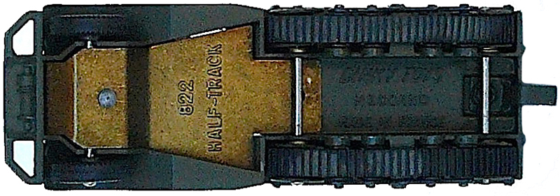

822 Half track M3. What about this one with a yellow baseplate which is probably dichromated ? It is the first such base plate that I have seen, in fact I have only seen this picture and the model is under investigation 300 miles from here. More about it later.

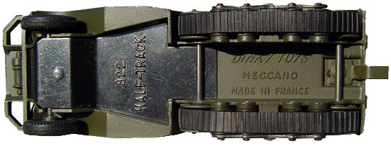

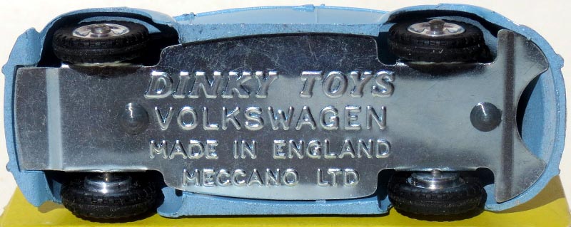

dinkycollect wrote: 'Terry, I certainly include all the different base plates for each model when I know about them and can obtain a picture good and large enough. In the Encyclopaedia, . . . . . . . . . . . . . . . . . What about this one with a yellow baseplate which is probably dichromated ? It is the first such base plate that I have seen, in fact I have only seen this picture and the model is under investigation 300 miles from here. More about it later.' Jacques I have not seen an 822 with that type of base plate - all those that have come and gone through my hands have been the normal gloss plates, although one does appear to have a satin finish although that could have been as a result of how I photographed it at the time as well as the lighting conditions. I am aware that this thread is all about MATT base plates, but thought I would throw in an image of the 181 Volkswagen with a plain/silver base plate and no sales number. (Would I be correct in saying that the 181 was the only Dinky to have an unpainted base plate?) The 181 Volkswagen has both gloss and matt base plates, as well as the unpainted base that came with the light blue with spun hubs version only, although there may have been other colours with an unpainted base plate, as nothing with Dinky Toys is definitive! I have not seen a matt base plate on a 181 either for that matter but that does not mean there are none 'out there'! Bruce
12 years 6 days ago #15163
Replied by Dinkinius on topic Matt black finished tin base plates

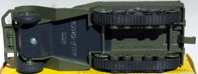

Jacques Thanks for the explanation on how the base plates are manufactured. Meccano would have had the making of these down to a fine art considering all the tin-plate products the company has manufactured for Hornby and Horny Dublo trains and their associated accessories. No need to change the title of this thread as the 181 is reported to have matt base plates as well. I am hoping that members who have examples of the 181 with matt bases would submit a picture or two to add to this thread. I do not have a matt finish 181 in my collection - just the unusual bare metal base plate, so I decided to share this with the readers of this thread. The below is of the 822 that I think might have a satin finish - but you no doubt can tell me one way or the other if this is correct! Unfortunately I am unable to examine it as it has gone to a new owner! Bruce

Bruce,I have seen that VW before, a late issue with spun hubs, no reference number and no bump above the Y of DinkY on the base plate.The use of the bump has still not been explained. It is probably a positioning device for positioning the base plates at each step of the stamping.The stamping is made in several actions on the same completely automatic machine. A reel of tin plate already lackered, varnished, brunofix or what ever treatment is fed into a stamping machine.1) The first pressing emboses the marking and cuts most of the plate which is still attached to the steel reel. On raising the tool, the reel is moved one step.2) The second stamping folds the plate and does operation 1 for an other base plate and on raising the tool, the reel is moved one step.3) The third stamping cuts the base plate loose from the reel and does operation 2 for an other base plate and 1 for a third plate. on raising the tool, the reel is moved one step.I suppose that the base plate of your VW is not made of bare steel, there must be some sort of anti-rust treatment.I can not change the title of this thread to 'Base plates finish' as all the messages would be lost.I am sure that other members will apreciate your VW.
This is my 822 with satin (not enameled) base plate.
