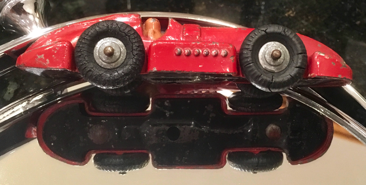

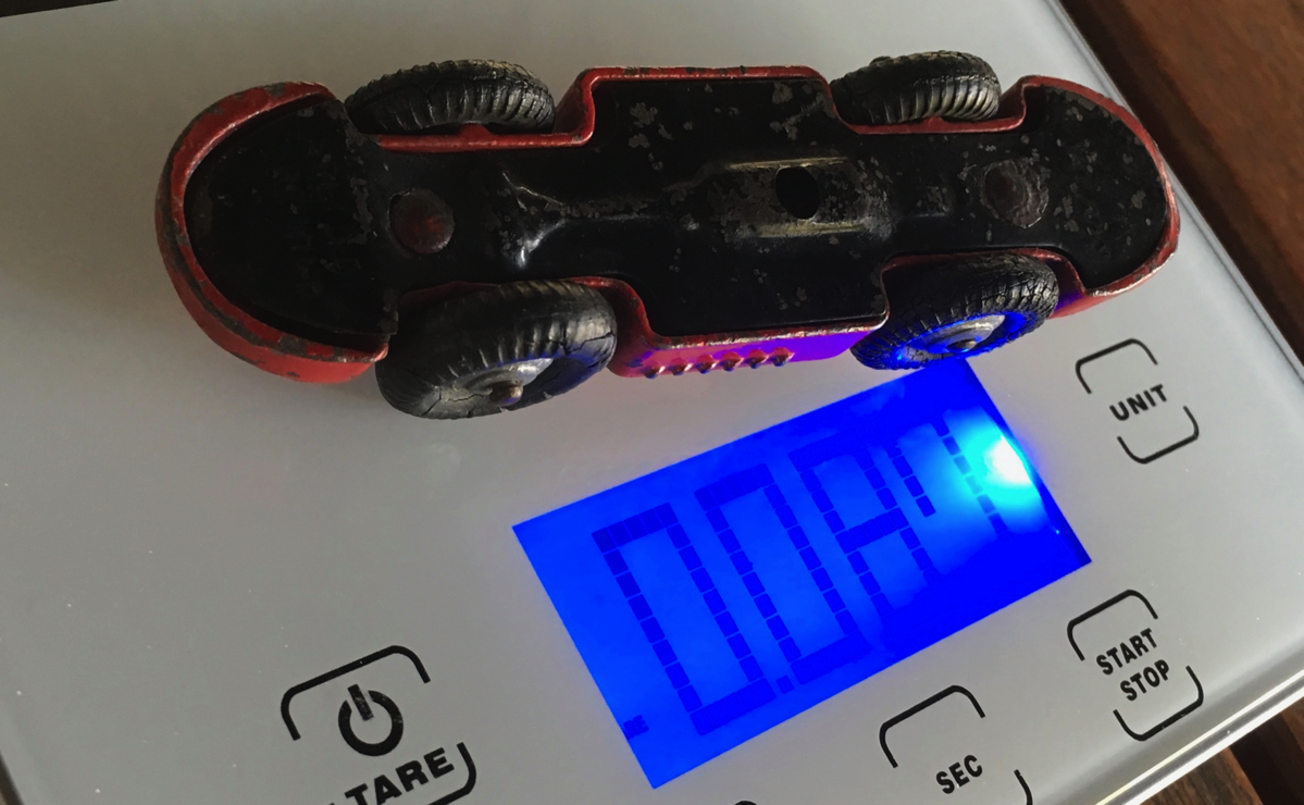

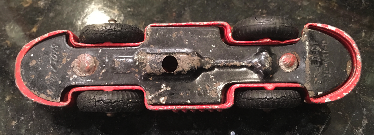

Hi John, just saw your comments and pictures on your lead 23e Speed of the Wind. I have the same in my collection, same color scheme, same weight, same ingredients of an early 50s issue: ridged hubs, rounded axle ends, baseplate without the two little 'angel wings' behind the rear axle, round DINKY SUPERTOYS tyres. But the funny thing is; on my model the baseplate has been mounted the wrong way, meaning the differential is under the front axle! Most likely a mishap, since the rivets are no doubt original. How about your model? Regards Walter
9 years 7 months ago #19577 by john45
Hello Walter, I checked the baseplate of the lead Speed of the Wind at my friends collection as it is not mine. On that model the differential is under the rear axle as it should be. So your model is for sure a factory error and thus not common! Nice find. John.

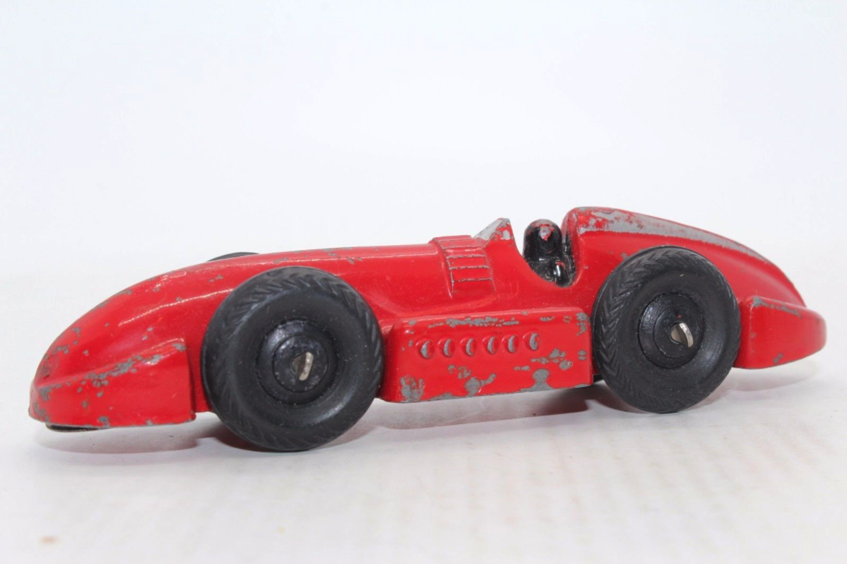

Hi Terry, here is another 23e Speed of the Wind with black driver, this time with the post-war ridged hubs and black herringbone tyres. Regards Walter

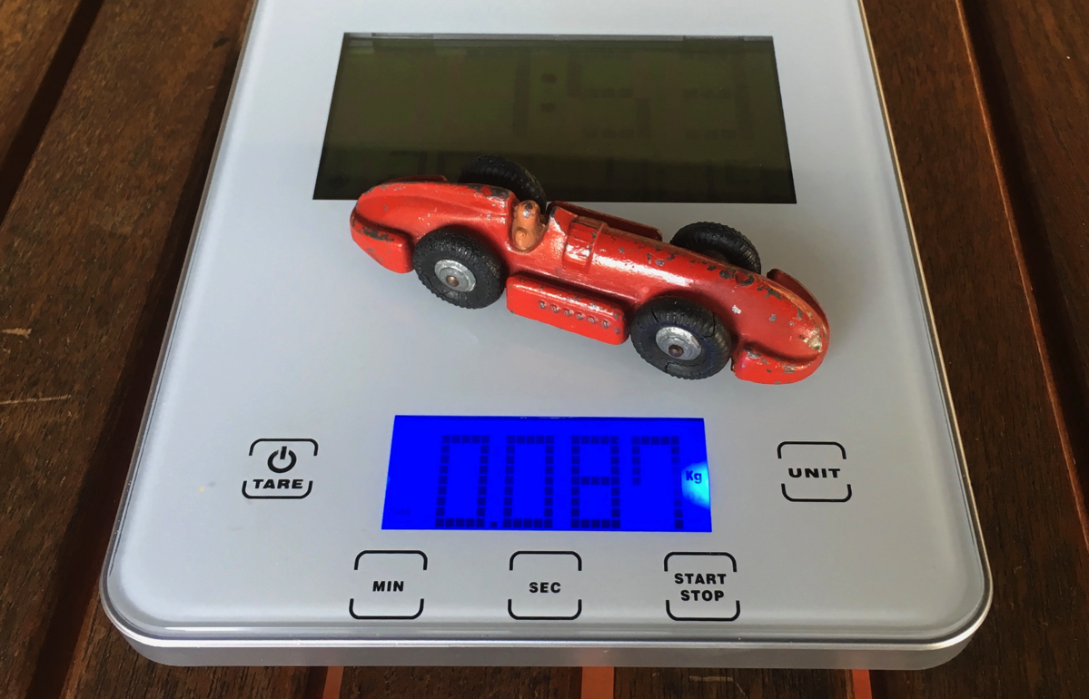

Hi Jacques, so glad your back. Here are two pictures of my front wheel drive 23e Speed of the Wind. Happy? Best regards Walter
