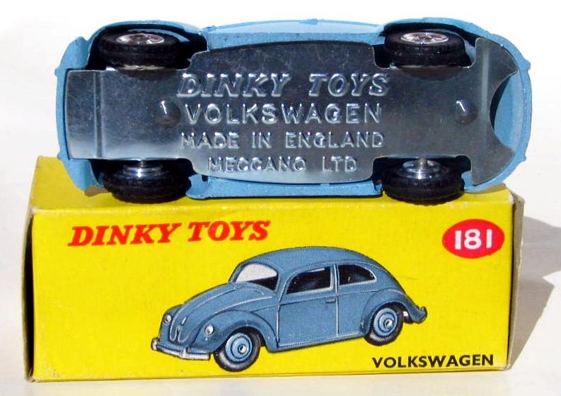

Two Volkwagens, the light grey one about 1957-1958, the blueish one ca. 1961 onwards.
The early one has the regular 1950s base plate, the later one the smooth shiny base plate. Lettering is the same, but the early one shows the catalogue number 181 and on the other one this appears to have been deleted. With what change does this transition coincide? The introduction of the 262 Swiss Post Car in 1959 or the introduction of the shiny base plates and spun hubs, about 1960/61? Your comment is appeciated! Kind regards, Jan

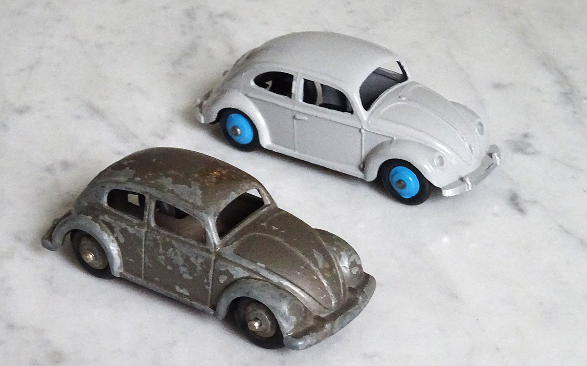

4 years 11 months ago #23399
Replied by janwerner on topic 181 Volkswagen Saloon (1956-70)

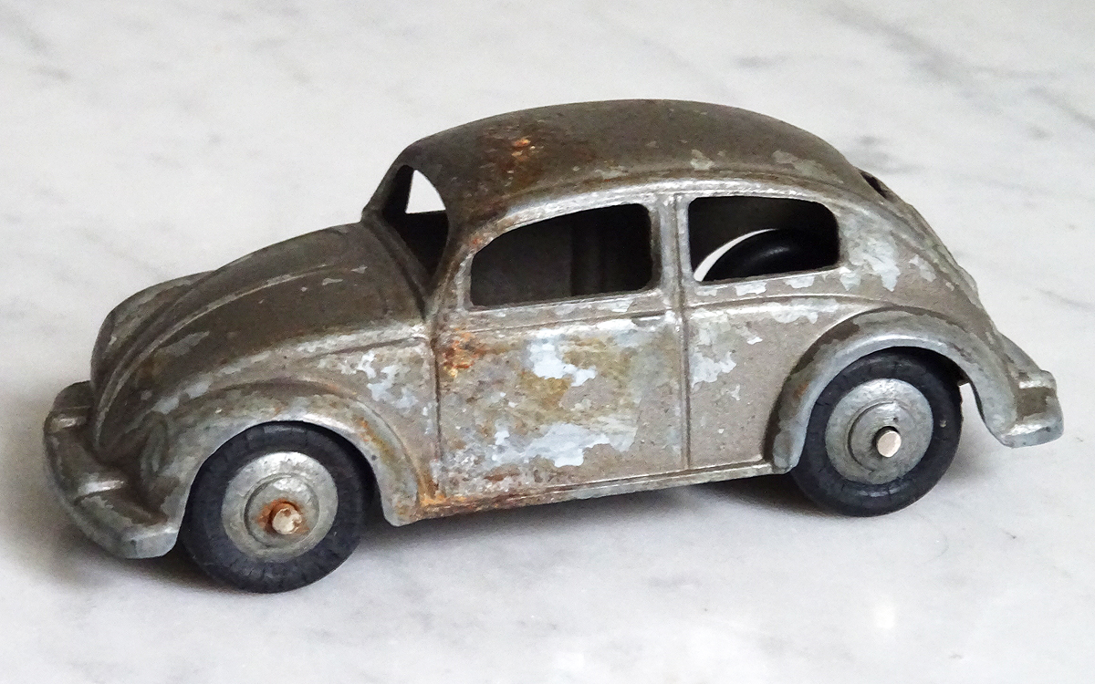

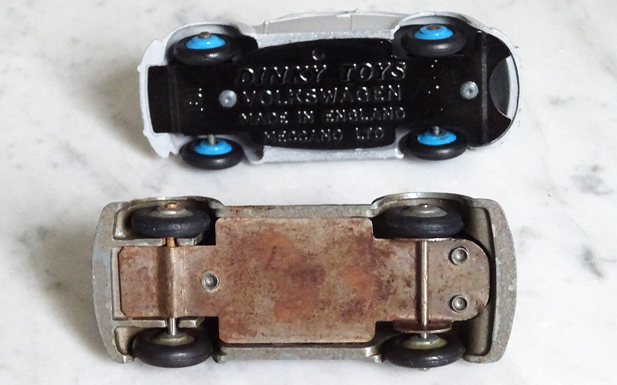

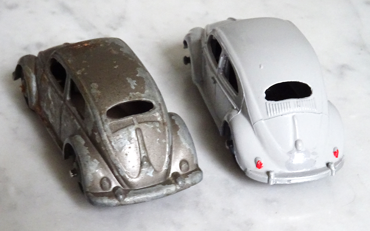

A friend of mine popped along yesterday to show the anonymous Volkwagen with mid-1950s oval rear window below. The base plate is completely bare. Its dimensions are similar with the Dinky Toy, but it's less slim, wider, fore and aft, and many tiny details are obviously different. Does anybody know about its origin, manufacturer? Some comparative pictures below. Kind regards, Jan
4 years 10 months ago #23432
Replied by dinkycollect on topic 181 Volkswagen Saloon (1956-70)
This is obviously a different casting from a different mould. The hubs are Dinky but has this model been made be Meccano Ltd. They are too many differences : three rivets, front axle suports, base plate shape etc... Has the mould been made by an aprentice and rejected ? has this model been made by an other manufacturer ? Perhaps Vic can tell us more about this one although it was probably made before Vic joined Meccano Ltd. An other of the many Meccano mysteries.
