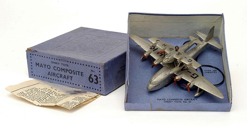

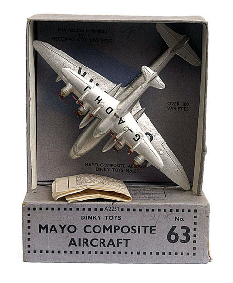

There have been a number of 63 Mayo Composite Aircraft sold through Vectis containing gliding instructions. If the set was designed not to be used for this game, the question remains, why include the instruction sheet? Gliding Game instructions were included in sets sold 10/10/06 (subject of Dave's post), 16/1/07, 9/9/08, 22/11/11 and 17/4/13. However, what is interesting are two lots sold on 17 August 2011: Lot 2656: Dinky No.63 Mayo Composite Aircraft - comprising Flying Boat Maia and Mercury Seaplane - both are silver, with red tinplate propellers, some fatigue cracking to front of fuselage to the Maia otherwise Good examples still with their gliding game holes and tinplate clip in a Good early box dated 1-39 and card insert. Lot 2657: Dinky No.63 Mayo Composite Aircraft - containing Maia Flying Boat and Mercury Seaplane, both have gliding game holes and tinplate clips, some fatigue cracking to the front of the Flying Boat fuselage otherwise Good in a Fair to Good card box with insert dated 1-39. Note the reference to tinplate clips. Of course the clips could have been added later, but there is still the question of the leaflet.

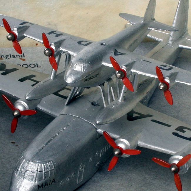

The clip can be seen on the Mercury as per the picture Dave downloaded although with the above image 'borrowed' from Vectis, I am not sure about the wire (rubber band?) things below the model. Jan The close-up photo of the 63 you attached shows what appears to be scratch wear around the gliding hole in Maia caused by something (clip?) being inserted and removed?? Bruce

Bruce, I believe there is enough evidence now that this couple was definitely sold with pin and leaflet.
The little scratch you're referring to is better visible on a photo than with the bare eye. I don't know if it's significant enough to witness use of a cotter pin there once or twice. May be one former owner tried, but one cannot expect much success because of the bracket bothering such an attempt. May be it's just my example that has such a losely clamp connection between Maia and Mercury but I will not attempt to bend anything of the clamp under the secondary plane. By the way, I do not have an example of the loose Empire Flying Boat to compare, so it's a mystery for me if the bracket mounting incisions on top of the wing are cast of have been 'cut' afterwards. I do not dare to manipulate anything there in order to investigate the solution chosen. No doubt John is our best expert here. Finally, have a look at this: Best regards, Jan

janwerner wrote: 'Bruce, I believe there is enough evidence now that this couple was definitely sold with pin and leaflet. The little scratch you're referring to is better visible on a photo than with the bare eye. I don't know if it's significant enough to witness use of a cotter pin there once or twice. May be one former owner tried, but one cannot expect much success because of the bracket bothering such an attempt. May be it's just my example that has such a losely clamp connection between Maia and Mercury but I will not attempt to bend anything of the clamp under the secondary plane. By the way, I do not have an example of the loose Empire Flying Boat to compare, so it's a mystery for me if the bracket mounting incisions on top of the wing are cast of have been 'cut' afterwards. I do not dare to manipulate anything there in order to investigate the solution chosen. No doubt John is our best expert here. Best regards, Jan' Jan My point exactly - gliding holes, pins, instructions, so the attachment to Maia must have been well secured, and the gliding game went on, the query of which was first raised. Thanks for looking at yours closely. I do not have a prewar Empire Flying Boat either, as I am rather nervous about spending hard-earned cash on something that in most cases are slowly deteriorating. (Off the topic here, but why is it the 62g Flying Fortress is apparently relatively immune to fatigue? I have three in my collection with two others that came and went and none suffer from any fatigue.) However, thank you so much for the link to the marvelous Movietone Newsreel of the development, first flight, separation, and flight across the Atlantic of this unique combination. What a wonderful tool is Google, as on viewing your link had I bothered to look for it earlier, there it was! One of these days I am going to have to find a better replacement for my Mayo, complete with gliding pin and instruction sheet! Best regards, Bruce
